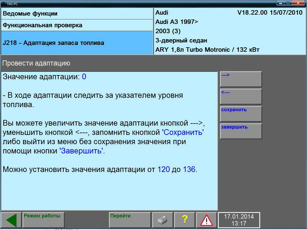

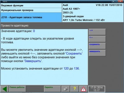

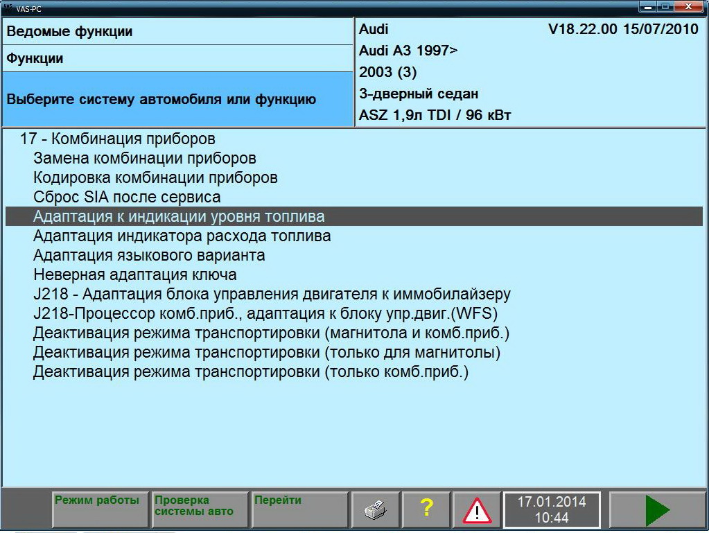

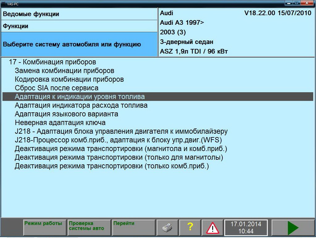

По А3 вообще ничего не нашел по откачке топлива. Есть только информация по проверке ДУТ в баке и калибровка ДУТ путем изменения его сопротивления.
Adaption channel 30 - Correction of fuel gauge sender resistance range
This function can be used to shift the fuel gauge sender resistance range if dash panel insert display does not correspond to actual tank content.
1 - Enter channel number
‒ Use keypad -2- to enter "30" for "Adaption channel 30" and confirm by touching Q key.
1 - Channel 30
Read and test
2 - Fuel-gauge sender
4 - Moving bar positioned on current adaption value 128
Notes:
◆ The adaption value 128 represents the factory-set mean fuel gauge sender resistance range.
◆ The fuel gauge sender resistance can be changed by ±8 ohms to an adaption value of 120 ... 136.
‒ Enter 5-digit adaption value. Use "0" to fill up empty spaces.
Example:
Desired input: 132
Keypad entry: 00132
Note:
Fault message "Function unknown or cannot be implemented at present" appears if an implausible value is entered.
Example:
1 - Channel 30
Value 132 saved
